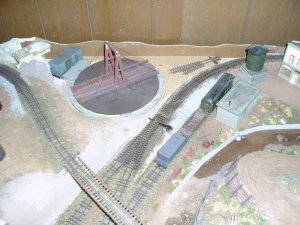

I want to complete the last remaining area of my layout showing any bare wood. I want to get the track hooked up to theturntable, and create a little scene here.

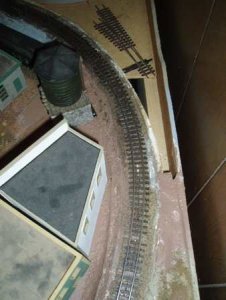

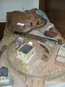

here is some photos of the area I intend to complete. I need to somehow shoehorn a switch off the mainline, either by modifying a shinohara or makng my own. As you can see, this is the last part of bare wood on my tiny layout.

yes, that is HOn3. The overall size is 3'x6', but it is still plenty of laout in HOn3!!

nope, it is all commercial code 70. i just followed malcom furlow's techique of painting each tie a different color. On a small layout like this, weathering each tie seperately doesn't take that long!!

And for the turntable, this is another idea borrowed from the san juan central. It is a cheapie atlas, 9" long. Not very useful for standard gauge because it is short, but is ideal for HOn3. I glued some wood strips between the rails using walther's GOO to cement the scratchbuilt bridge to. The bridge is entirely scratchbuilt using basswood, and the HOn3 rail attatched using PCB ties and either GOO or CA. I built it a few years ago and don't have photos of the construction.

ooh, I need to get going! between schoolwork and a new girlfriend I havent had much time! I've taken an old shinorhara turnout that had some warped ties and was out of gauge, and tried fixing it and modifying it with PCB ties. I still havent quite figured out how i can lay this turntable lead track. On such a small layout, squeezing in sidings and turnouts can be tricky!!
