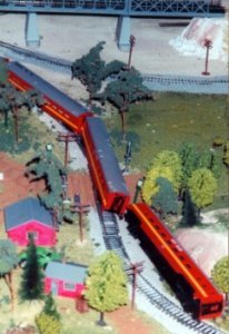

    This is what happens when you don't listen to the experts. I have a 4ft x 4ft spur on my layout. I used 18" raduis. I was warned by the local modelers, when I purchased my IHC cars. They warned me I WILL have problems. I sure did!
    Look at my picture very carefully and you will see what I mean. To make matters worst. I added a tunnel! That was a stupid move. After some modifications, it doen'st derail as often. Next time I wont be doing something like this! I learned by not listening and making mistakes.
    Best of luck,

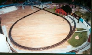

    Here is another stupid move. I wanted a loop inside of line 2. The track is 18" raduis. It works fine for small frieght but not the IHC cars!
    Andy

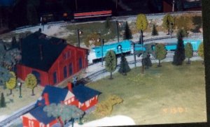

    This is part 2. Look at that stupid move I had done! I put my main passenger station in that darn loop! I could never use it because the train would derail! Since then I moved it out of there. Works alot better.
    I have learned alot. Most of the time it's poor planing. With being on a budget, I can't just rip it out and start over. Even though I wanted too! So what is the loop being used for? It's being used for storing extra rolling stock. (Didn't add a yard..another dumb move). And storing my extra locos in the round house.
    I know the experts on here would laugh at my mistakes but I did learn from them! I guess over time, that's what makes us experts! Would I do it ALL over again with different planning. Most diffenately. I know have computer software to help me lay the track unlike when I started.
