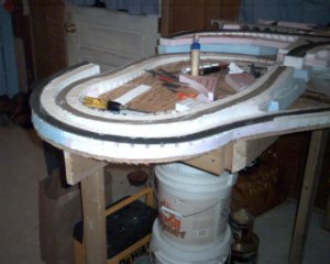

    I run N-scale and I needed the widest radius I could get out of 24". If you look closly you'll see my road bed is right on the edge. My plxi-glass fasia will come up about 4" above the tallest point of the hill. that will keep the train on the lay-out and will keep the cats of the lay-out.
