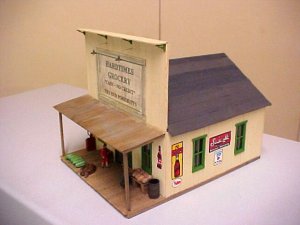

    Catt....Thanks for this new forum. Here's one I finished up a couple of weeks ago.

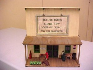

    Vic Active Member
    Just a side view.

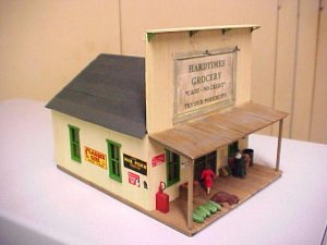

  3. Vic
    Vic Active Member
    The other side. Built from scale lumber and Grandt Line windows.
  4. Drew1125
    Drew1125 Active Member
    Very nice work, Vic!:cool: :cool:
    I love all the signage, & the front porch detail!
    How did you build it?
  5. WVRR
    WVRR Member
    Vic,
    Very nicely done...beautiful work..and those watermelons are sure well protected. I have the same question as Charlie, what materials did you use to build this? It looks great!!
  6. Tyson Rayles
    Tyson Rayles Active Member
    Very well done Vic, but my neighbor says he wants his dog back!!! :D :p :D
  7. Vic
    Vic Active Member
    Thanks for the compliments
    The little store is built from Northeastern HO scale lumber and the windows are from Grandt Line. The sign are dry transfers from Woodland Scenics. The watermellons, dog (he's too big) and veggies were carved from that modeling clay that you heat in the oven to harden it. The tarpaper roof is made from strips of newsprint colored with washes of Floquil driftwood, grimy black and roof brown. The screen in the double screen door is brass mesh from Clover House There's no interior. The sign was made on the computer. The porch roof is Campbell metal roofing The rear has a large delivery door but I didn't show that as I felt I might be taking up too much room on here as it was.
    No prototype on this one...I tend to just make up stuff, sketch it out and build it.
    Glad you guys liked it and I'll post more stuff later on.
    PS: The "lady" in the red dress plays the piano in the saloon next door to the grocery:D :p
  8. Matthyro
    Matthyro Will always be re-membered
    I sure like your creativity Vic.
    A store like this would have a home on any layout.
    Good work.
  9. roryglasgow
    roryglasgow Active Member
    Beautiful work, Vic!
    I have a list of questions:
    1. Did you build the walls board-by-board or did you use sheets of "siding?"
    2. How did you get the weathered effect on the store sign? Did you print it that way or do something to it afterward?
    3. Do the lights out front work?
  10. Vic
    Vic Active Member
    For Rory
    Thanks for the questions on the grocery store. The construction is board on board and not sheet siding. I did "fudge" just a bit though since I did not plan to model an interior. I first built a "shell" of the building out of light bristol board, reinforced the corners and walls with square stock, cut out the window and door openings and then applied individual boards to the outside using plain old white glue. The trick to this is to butt the boards tight against each other. Kind of a "down and dirty" method but it works well.
    The exterior lights do not work. They are "dummies" from Grandt Line. Wish they did!!!:eek: The corbels on the false front are also from Grandt Line.
    The sign was made on the computer using the Paint program in Windows. Its simply glued to a piece of .005 styrene, framed out and glued to the building. Actually the "dirty" look of the sign was unintentional:eek: The result of an accident!!! Before mounting it to the building I spilled some blackwash...thinned India Ink on it. I attempted to wipe it off and what you see is the result:D Just let it go because the color cartridge in my printer was empty:p :p
