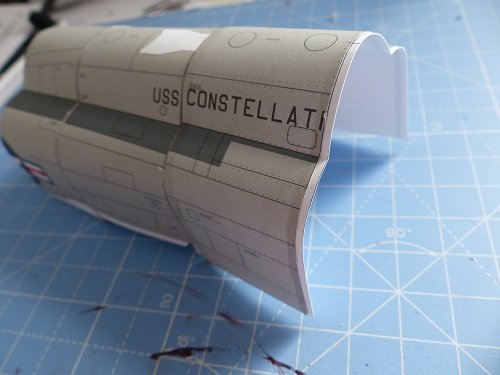

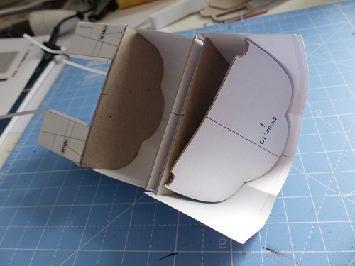

Hi everyone.
I'm newish to paper modelling and in lockdown bought the above kit, made a mess of it and bought another to do 'properly'.
The instructions are quite basic (and in Polish), and I cannot see how the fuselage sections are supposed to be joined to each other.
Each end of the section has a bulkhead frame and also a strip tab for one end, but you cannot glue the bulkheads to each other and use the strip
as well. Are they an alternative method? I'm flummoxed, and want to do this properly.
I await your expert advice.
Steve

sounds like you can use either the bulkheads glued together, or the spanner strip, but not both?
12,531
9,914
You can laminate the bulkheads and wrap the spanner strip around the bulkhead (making certain that the bulkhead is in the center if the strip). Then sliding the skin over the strip.

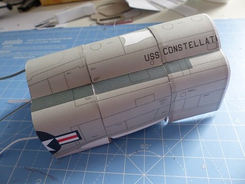

Thanks for your interest and suggestions. I have meanwhile come to the idea that indeed, you cannot use both. I think the bulkheads are essential for giving the shape of the section, and they should be glued face to face. You might see from the attached photos that gives the best finish (both are not good!) This kit is probably a step too far for my skills. It looks like you chaps don't use kits much? I did get the instructions translated by a Polish lady, but I fear it was a bit technical, and even web translations get confused. On the papermodelers forum, someone built this kit, but without much explanation. Last year I built GPMs Challenger tank, which took a long time but was easier because everything was flat! I might do a build thread.
The photo files appear too large, so I'll fiddle with them and post later

Never use that tabs that come with a model. Cut them off carefully. The glue strips on the inside on one side of the part first. Make sure no glue gets on the part at the edge of the section so you can then line up, check for fit, then glue the next section onto the strip. This will put each part on the same plane. Tabs that are part of the model throw the adjacent part to a plane the thickness of the model. That's why they should be cut off. Always dri fit, and cut glue strips where necessary. Many times "less is more', if you know what I mean. Alwways try and get those edgest tight before you glue. It makes for a much more satisfying model, and will encourage you to keep going. Welcome to Zealot! )

Thanks Zathros. This model has separate glue strips that you glue to the inside edge of one skin, so the next skin is aligned in the same plane. But it is impossible to use these strips and also have a bulkhead that is glued directly to the next bulkhead, the bulkheads giving shape to the section. If you use the strip to get good surface alignment and a bulkhead to get the section shape, there is always a gap of 2-3mm, which gives a slight dip in the skin surface. Tricky!
