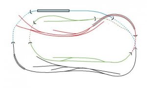

I would personally go with H0 if you need glasses like I do. Anyway, if you want to have a really good looking H0 in 8' by 4', then I would suggest a shortline/mining/logging line. I can help with a plan for 8by4 if needed. On the other hand, if you really must have long trains, then N-scale is the way to go in such a small space.
Here's a track plan for an 8by4 in H0, (It's a logging layout)
Cheers
Shamus

Frist, thanks for the input on my problem. Next, thanks to ypu Shamus for your layput plan. aaaaaaaaaai'am thinking more along the the line of a folded dogbone with a 5or6 rail yard inbeteen the 2 loops. I'ed love to see what you could do with something like that.Finly the choce of HO or N. i think I've come down on the side of N.scale. It gives me more room to run around in and still have room to expand if I want to. I can do more with the yard too. ie, turntable, engine house, repair house, ect.Next ,I have to order a catalog and look to see what i want. Again' thanks. John PS this is a great place o get help.I'am sure I'll be asking for more in the future.
