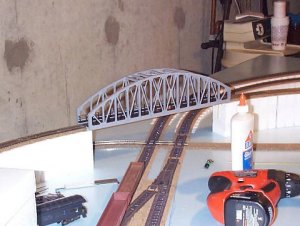

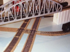

Wasn't really satisfied with what I was wanting to develop as a branch line that would intersect with a major rr on my layout. After waking by the layout everyday for a month the little light bulb in my brain came on ever so dimly:D :D
The pictures show where I am with this part of the project. In addition to just having the branch come into the yard to meet with the mainline (UPRR, of course) I now have "engineered" it so the branch will actually cross the double mainline during its travels back to Boneyard Valley. We also have another part of the mainline crossing over the double crossing which might just make this the place to stand to watch some action, eventually:D :D

Hi Bob old friend, that double crossing looks fab, did you manufacture that yourself? if you did, thats excellent craftsmanship. I wouldn't like to try that myself. Wow.

Thanks for the compliment. I did make it myself. Took me longer to think it through than to actually "build" it. Not near as difficult as when I made the two double crossovers I did early on. With those a third hand would have been a real blessing.
Actually, I thought about you several times while doing this thing as I keep thinking, "remember what Shamus said about transition curves, this is what he was talking about."
The space is rather tight coming into the crossing, but I can get everything I own around and through here except my heavyweight passenger cars and I have no need to get them in here anyway. This is going to be strickly freight with a series of spurs to various businesses, and maybe a two stall engine house.

Got a question Bob, on that crossing, where are the power points, or is it long enough for the loco to straddle it.

There are actually three power points. One already installed off to the side where the track continues out of sight and two to be installed, one in the center and one to the side where I have not yet extended the track. I'm trying to make up my mind where I want to put in a series of turnouts for the spurs and when I figure that out I'll know where the power will go in. I'll solder in the connectors between the mainlines shortly.

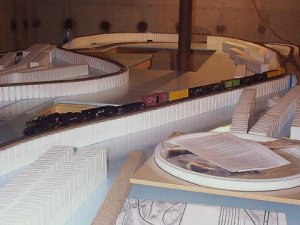

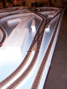

Here is another view from the other end. The layout is 10' X 22' based mostly on Plan # 82 in Linn Westcott's 101 Track Plans. I expanded it by a foot in each direction to allow me to widen the radius of the curves a bit.
I have the basics of DCC installed, but have everything sort of torn up right now as I expand my branch line.
