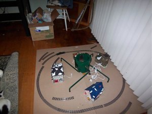

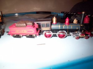

pictures from Aberdabr
Here is some pictures... not the best but you have an idea if I did this uploading right. :mrgreen:

Aberdabr: the loco you have is 119, one of the 2 golden spike locos from the joining of the UP and CP.
The model looks like a Bachman one (a lot like the Walt Disney one I just got). The coupler on the back is called variously horn-hook, NMRA, X2f, or *#@$%$#. (NMRA and X2f are wrong, but common.) It's been the standard train set coupler since the late 1950s.
If it's like mine, one side picks up from 2 tender wheels, the other from 2 tender wheels and 2 on the front truck; there are rubber traction tires on the rear drivers.

Thanks David. I still dont know how to connect the train together.wall1
I am afraid of breaking it.

You should just be able to put the cars on the track and push them together. The couplers should automatically link up, like shaking hands.
Each coupler should have a sideways half circle opening; the outer part of that opening fits into the opening on the next coupler. There should also be a bit that sticks out in the other direction so that the couplers slide past each other as they come together. If you don't have all these bits, the coupler may be damaged.
There's also a possibility that you may have a different type of coupler. Can you get a photo of the ends of your loco and some cars?

From what I can see in your pictures, you have something very similar to what is in my basement right now for my 2 kids (3 and 6 yrs). It looks like you have two 2x4 foot sections with the long edges together.
As I contemplate doing a Christmas layout, I was thinking about modifying my 2x4 modules to each be a "1/2 donut" shape. That way, the tree can poke up through the middle, while still giving enough real estate to do a convincing Christmas village and train track.
The two halves can then be taken apart and boxed together for storage until next Christmas.
As David said, the easiest way to get the cars hooked together ("coupled") is to put each on the track separately, and then push them together. The couplers should automatically engage. To get them apart, push the cars towards each other to create some slack, slide a small screwdriver between the couplers and twist them apart. Or you can simply lift one car up and set it back down somewhere else...
