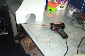

I made my own hot wire cutter from an old soldering gun. I removed the soldering tip and inserted a piece of #12 copper wire. You can bend the wire to any shape you want, just make sure it doesn't touch itself. I made different "blades" such as a long thin knife for basic cutting, a tunnel shaped one for excavating tunnels, a wide, flat one for general contouring, etc.
Doc
