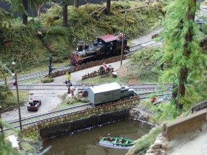

Hi Bill and welcome to the gauge, I note you are using "gloss latex polycrylic " for your lake/pond etc, I use High Gloss Yacht Varnish for all my lakes, but I should expect your gloss latex polycrylic to be on the same lines. What you have done already is okay, when seating the boats in place, don't glue them in just let the new coat of gloss latex polycrylic do the job. Be careful, because when things are added to a varnish bottom and another layer is added, it tends to crack around the article and flake at a later date. Just use a very very thin coat and let it dry for at least a week before another coat is added.
