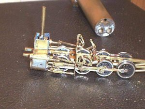

I've posted this photo here before a long time ago. This was built without a lathe.
I have had it running on 20PSI. of air preasure.
I was planning on using solid fuel pellets but was having problems with draw through the flues. I am thinking of redesigning the boiler with one large flue and modifying a butane torch head for the burner with a preasure regulated burner control.
Do a web search on steam locomotive valve gear to find info on timing and valve gear design.

Eric,
I really haven't decided if I'm going to finish this one or start over now that I have a lathe and milling machine.
I am thinking of building a larger boilered 4-8-4.

Yea , it is alot of fun to play with.
Opening the throtle (a small spool valve between the cylinders) and adjusting speed and direction by moving the reverse lever.
Once it fell off the blocks I had it set up on and it took off across the bench. It was stopped by the 3' aquarium air line that was attached. What a rush, I had visions of it bouncing off the floor.

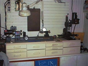

Jon,
I found a Sherline model 4400 lathe and a model 5400 milling machine at a pawn shop. Included with the deal was a home made wood base with drawers that had all kinds of accessories, micrometers and a dial indicator.
These are nice machines. Here's a link to the Sherline site.
http://www.sherline.com/
