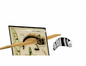

I have found Rhino3D to be the best program for organic shapes. Probably because it models using N.U.R.B. (Non Uniform Rational Bezier Splines) and this puts it far ahead of many programs. it is the way Rhino3D utilizes this method, first discovered in the 1950's. AutoCad, to me, my personal experience, is the most non intuitive program I have ever used. Rhno3D just seems natural. Pepakura cannot touch this kind of modeling but can lay the foundation , like an armature, to create something better in Rhino3D. I don't use Pepakura, but do have respect for some of the magnificent models made using it.
I have to use Rhino3D as I make objects that become parts that have nothing to do with paper models. But Rhino3D is a great program for paper models, and with a student license, you can get a fully functioning commercial version for $200 dollars!
I extracted a lot some of the Nausicaan Gunship from this pictures, and a few others, to get the model. Everything unfolds in this model. This would have been a bit more difficult without a computer, but only because of time, you can save a lot of time with a computer with something like this. It can be done without a computer.
When I made models without a computer, when I was very very young. I would build the formers, the firmly mount the frame and use a string to measure each former and measure the wide and the height difference. This gave me the panel lines. Measure the strings for length, the height difference gave me the start point of the panel line and the width was how wide the panel line would be. That is essentially what the CAD programs do. I have seen some really convoluted methods people use when using Rhino3D, and it is really bad. Computers equation, cr@p in=cr@p out.
An example of NURBS modeling. This lines can be extruded into surfaces, or revolved into solids, etc. :)
