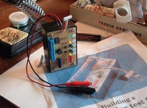

While waiting for Walmart to decide whether it wants to take my railroad under its new found right of eminent domain, I put together this here DCC decoder tester based on an article in the Sept. '01 RMC, page 89-92. I made the "Plug-n-play" socket by modifying an 8 pin IC socket. I added a Digitrax wiring harness into the circuit because that is the dominate decoder in our club. I also went for an industrial look (read that: impress the guys at the club with my electronic prowess ;) ) by moving the components to the front rather than hide them behind the graphix. Provisions have been made for sound chip testing in the future with the addition of a speaker and four more terminals.
I found this an easy electronics project to do having only done one other, a transistor throttle, and that over twenty years ago. It was my first using a perferated circuit board.

Yep, got busted when Carol's E8 didn't run. When Bill found it was the decoder after much trial and error, I vowed to build this thing once and for all. No decoder comes to my shop without going thru this thing :thumb:

See what I mean, just move them little doo-hickeys and whutzits to the front of the board and everybody thinks you're an electronics whiz. :thumb:
Robin, I've found that, if I read the schematic just like a roadmap, it works out just fine...well, that and a good, hot soldering iron...and maybe a good, clean cotton sock to place in my mouth when the vile explicatives commenced to welling up within my innermost being ;) :thumb:
A great website that helped me thru the tougher symbols>>> http://www.kpsec.freeuk.com/symbol.htm

Used the tester for the first time today...is it me or does Digitrax cross the white/yellow functions? The NMRA standard says white for front headlights and yellow for rear and danged if I don't wind up with just the opposite near everytime. Other than that, it works just peachy, I highly recommend it as a beginner project.
