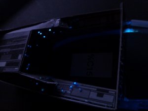

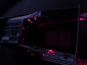

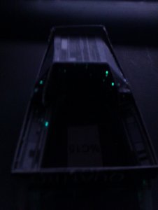

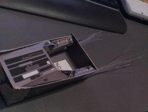

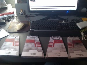

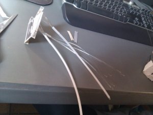

Ok the cockpit is fiber-ready...i think..
Now the led compartment in the back :)
And i want to try to split up some of the fibers to let them shine only one color.

The fiber-cockpit fits J
But I can install it only one time..
When I remove and insert the cockpit to often I think the fibers will break.
So now I have to wait until I know what to do with the Leds
And I need to make an Fiber-R2.. would be fun..

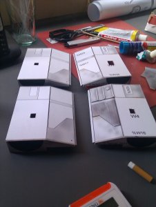

The first pic is a test fit for the droidplate.
And the last picture I have done something wrong there is a little mis-aligned that I need to fix

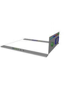

In stead of a stepping motor, use a motor with a cam. You can change not only it's left to right view, you could, if planned out right, include an up and down movement.
I have attached what I tried to explain about Fiber Optics. If you cut them very short, just enough to fit through the panels, you could insert LED's where ever you wanted. In this case, behind the colored parts which simulate panel lights, in this hurriedly drawn panel. After placement, you could cover the backsides with whatever worked, boxes, black silicone, with whatever works. This would alleviate problems with long fibers breaking and make for an overall more compact design. This is just an idea, not a criticism, your model looks great!! If you want a more detailed drawing, I could make one for you, but I think you know what I mean. :)

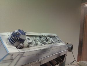

1 R2 with lighting..
i attached the legs..and when everything is dryed i cut the fibers
this R2 looks better then the first one :)

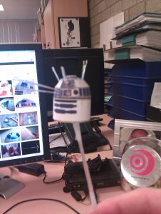

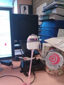

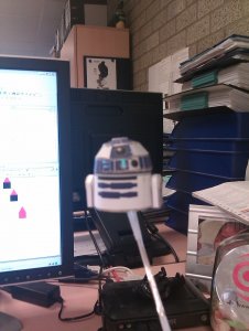

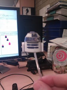

ok some more pictures.
With the lights on...but the led isn't perfect aligned with the fiber..
that's the reason the lights are a little dim ( i think)

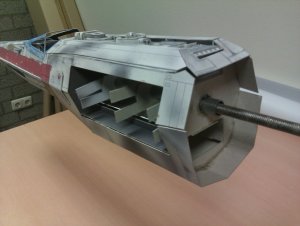

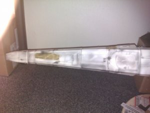

ah these are my wings i want to fly with...
Now the engines...

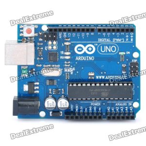

Today i ordered my Arduino...
I hope i can program it for the leds.

Tried to hotglue the leds on the fibers and that works, so when i install the leds with the fibers i can hotglue them. and then wrap some black tape over it for tampering the shine of the leds totthe outside.

That's a nice circuit board. When our done, buy a can of sealer and spray the board. This will make it last lot longer and prevent any corrosion. :)

Most circuit board are already protected when you purchase from the market. What they do first is they tin the hole circuit board first , then after they coated with a UV solution protector. If it's double sided they pop rivet both sides of the track first , then sliver tin , then UV protector. but if you spray it with circuit board sealer i would take out that ATmega IC chip out first before spraying it. Use a IC remover tool. & also have static free wrist band before handling that IC chip they are very fragile with static, the other components don't matter if you spray it. when putting the IC back into the socket the IC has a notch only on one side make sure the notch is the same way as the one on the socket or the white printed outline of the socket. but if it is a SMD ATmega IC or other SMD IC i would not recommend spraying the board. I've done in the past with project with AT mega , 74LS chips so on & so on , they are sometime pain to program if not done right or they did not handle the IC very well which leads to failure in programing them or faulty IC. but very uncommon these thing happen.
Over all with that Arduino you can do alot of things with that & they are simple to program when you use there software even with lights , LCD display & alot more. Great choice you pick.:thumb:

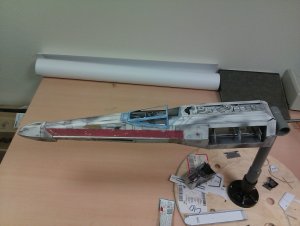

the belly is fixed at the nose cone..
somehow i had a big gap...now it's better.....
and loading doors attached.
