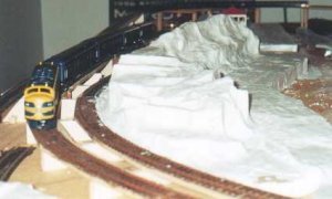

risers
John,
I just used 1/4" balsawood, with risers every 6" or so, and wood glue to glue it together. You can cut/shape it with a hobby knife and sands down smooth very easily. It's strong and I've had no problems. Don't forget your transition to the level to the rise. Do a search in here on "incline" and you'll find some real good info.

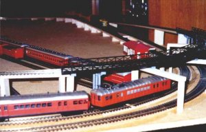

Woodie I like that colour scheme on the train in the last pic, but do all Aussie trains pull 3 G's on the curves? :)
The ones around Perth don't, (at least not while I was there) but things might have changed in 44 yrs.
Errol

Thanks for all the information on spaces between risers. My base is 3/4 plywood covered with blue wall board.I plan on useing the woodland senics risers. I like the idea of useing balsawood.It would be easy to work with and cut easier. Thanks Woodie.Useing that i may be able to save some money and make my own risers. Again thanks you all. You've once again showen how much we need and use the Gauge. John

Errol,
I don't like it actually, as a coloour scheme, however I wanted the setup. It was a scheme introduced in Victoria in the late 70's, and there is still rollingstock around with that scheme.
Pulling 3G's?? Yep... and it's stationary too! I've mentioned in here before about my curves being too sharp and unrealistic.... that's the consequence. That one is 20" radius.
John,
Yeah... I found balsawood very easy to work with, especially when building elevated curves. During contruction, you can hold it all together with ordinary sewing pins, before glueing it together. It's also very easy to shave off the beginning of your incline to make the level surface meet nicely with the incline surface and "transition" the incline. It's also very easy to pull apart should you need to modify it once glued.
However, ensure ALL the roadbed joins are sanded very smooth, otherwise you do get a bit of a bump. I did not use cork roadbed on the balsa. Just laid the track straight onto it, and again, very easy to pin the track down, without the need for a hammer. Once ballasted etc, the glue holds it in place anyway.
