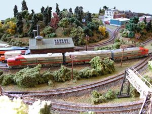

A little photoshop...
The final piece of the Super Chief arrived today...the extra "A" unit which allows the Chief to run the A+B+A power arrangement. My biggest concern is the dummy B unit between the two powered Kato A units. It was the correct weight per NMRA standard, but I added .5 oz since the unit is sandwiched between two power units. Unfortunately, it still derails. I think I'll need to run the slightly faster A unit at the point and the slightly slower A unit trailing the dummy B unit. I'm guessing the B unit is getting pinched between the two A units and lifting the truck mounted couplers just enough to derail it over turnouts. Plus, the weight difference concerns me...I might add weight to the dummy B to equal the A unit's weight.
Anyway...just a little photoshop to the picture to remove the venetian blinds by the layout's edge. I'm still learning photoshop so bear with my results...it took me a while just to get the sky the same color.

I just saw these latest pics.....GREAT GREAT modeling!!!! The trains...The scenery...All the little details....Up to and including the quality of the pictures...Herc, I can't say enough about your work, Very inspiring indeed:thumb: :thumb: :thumb: :thumb: :thumb:

hi herc---i really like the shot coming around the bend---the lighting is perfect---very realistic scene

Hey, Herc, I liked these pictures when I first saw them and your diesels were brown and silver. :rolleyes: Now that I can see "red", they look even better!!:thumb: :thumb:
