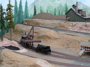

I was going through previous posts and saw a thread that showed a picture of your Badger Creek with brown parcel tape as a scenery base.
Could you please explain this a bit? Do you use a cardboard-lattice type support, covered in...PACKING TAPE?:eek: If so, please tell (me) all about how this is done, as this seems to me to be brilliant!! How does the plaster actually stick to the tape?? I've tried wire mesh, styrofoam, and others, and was never really happy for one reason or another.
Please tell!
Please tell!
Yes, I use interlaced card first and staple the odd ends together then put parcel tape (Brown) all over it. Undercoat Plaster (Bluehawk) is all I use to cover the tape afterwards and it sticks to it like "glue" to a blanket. Here's another photo showing some plaster also.

Here's The Thread!
As requested, here is a link to the thread. The main topic had nothing to do with the use of the tape as a scenery base, but I was FASCINATED with the idea of using packing (parcel) tape over a cardboard lattice, as this looks to be quick and NEAT!!
Here is the thread.
http://www.the-gauge.com/forums/showthread.php?s=&threadid=1443
I hope that Shamus can find more photos, as this is a method I must try. :D
Thanks, Shamus!:)
