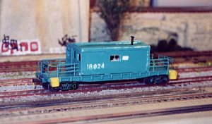

I've always liked these. They have such a distinct look. First one I saw was in the early 70's and I've always wanted to model one. 30 years later...I finally did! I used pieces from two cheap second hand Tyco cabooses and a flat car. The whole project cost under 10 bucks and I still have Jade green paint for more PC equipment. :)
Like a lot of PC equipment they were lettered various ways, some with the words Penn Central above the window, some with a logo to the right of the window, some with both, some with neither!
Here's my version waiting for a locomotive...

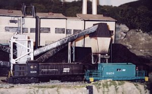

The transfer caboose is put to work on a one car local to Marion Aggregates and is seen here waiting for the RS3 to drop off a solitary hopper. I posted these pics yesterday on the very cordial Railroad-line.com but wanted to show them here at "home" too! :)

How Long Did it take to build?
Does it have an interior?
Do you have any idea what they were used for? Such as why does it have flat car ends?

Can I ask what the building in the background of the second picture is?
Is it a full building or just a half-build half backdrop?
Would it have any use next to a coal mine or tripple?
I was also wondering about the grafetee on the building in the first picture.
What did you use to make it and is it after a prototype or freelance?

Thanks Eric!
I spent about a week on it. The challenge for me was filling in the extra window on the side walls of those Tyco cabooses and getting the walls smooth. As I understand it, a transfer caboose was used as an office for transfer runs from one yard to another and also on local service when the finer amenities of regular cabooses weren't needed. The PC units were made of old box cars placed on a flat as a base. I didn't detail the inside but check out this link to a former transfer caboose now serving as a hotel room!

The structure is a full one (about three inches deep and a foot wide) built into the side of a hill. Its a very scaled down version of an aggregate plant near Mt. Marion, NY near where I lived as a kid. From the road you could see the complicated conveyor system dropping dark grey/black stones into open hoppers. Behind it (much farther behind than in my model) was the windowed structure you see in the pic. Behind that in real life were three long cylindrical kilns. I believe they heated materials and then transfered them up front. They'd drop red hot rocks out of the front of the structure and then be moved by the conveyors. It was cool to see at night! The building looks like a lot of classic mining structures to me.
The grafitti is freelanced and made from a white-out pen and some colored markers. There are some great sites with grafitti pics on frieght cars. I looked at them for inspiration.

Eric, I made one by cutting the ends off a scrap caboose and glueing to a flat car. I made the cab about 1/3 the length of the flat car, and filled the seam where the havles were glued with "spot putty" (found in the auto section at Walmart with the body work stuff).
Also, if you are less inclined to cut up rolling stock, I believe Walthers had a kit to convert a flat to one of these babies. I can't find it on-line, but I can look in my paper catalog later if there is interest.
