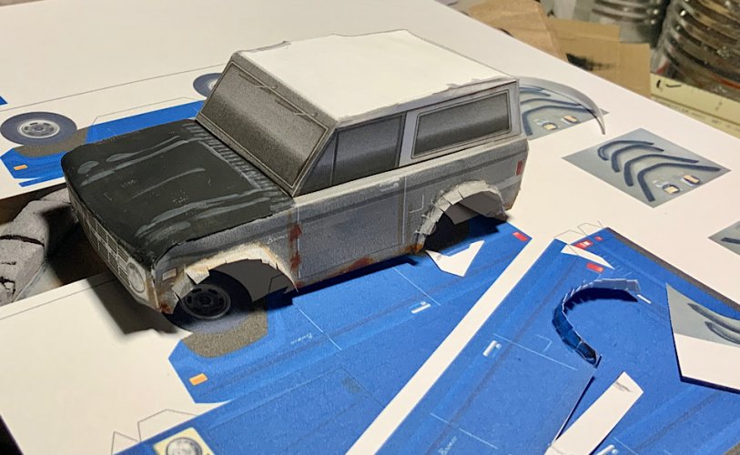

I did a little paper cutting while waiting for the doc to call us to the clinic.
The little prototype bronco printer paper test piece showed me how to make the fender flares. I penciled the outline of the top edge of the flare on the side and cut tabs up to that line. Then they were trimmed to the width of the flare. This will work. So, I printed some card stock parts to prove the concept with. The second pic shows the idea. Tabs, cover piece and then an outer piece for the edge of the flare.

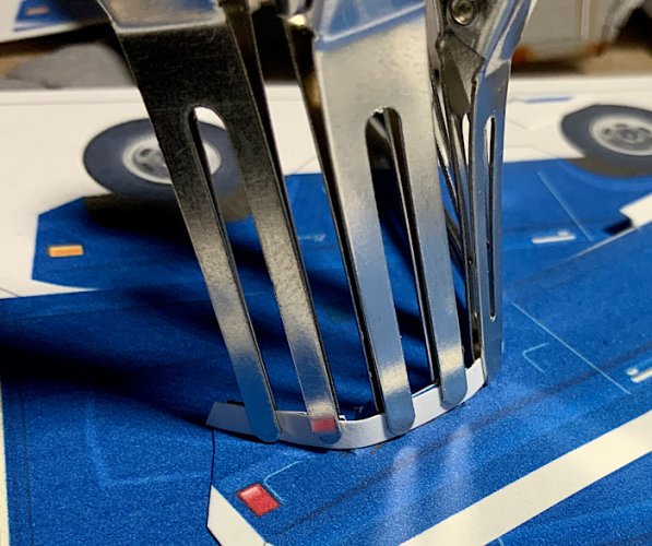

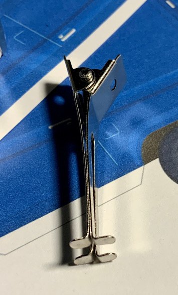

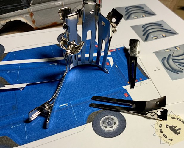

But Brown brought a goodie box today so I had to open and test the contents.
These are hair clips. I’ve used them for years as glue clamps but couldn’t find the ones that are somewhere, so more came. They are cheap.
The single point ones go into small areas nicely. I clipped the rounded points off of those I tested so they would fit the job better. They can be bent or trimmed lots of ways. The double point ones are my favorite. Trim, bend, cut to your needs.
I bent this double point to show one way to use them. This is for flat to flat clamping. You can of course cut off one set of prongs and have a really skinny, long reach clamp.
