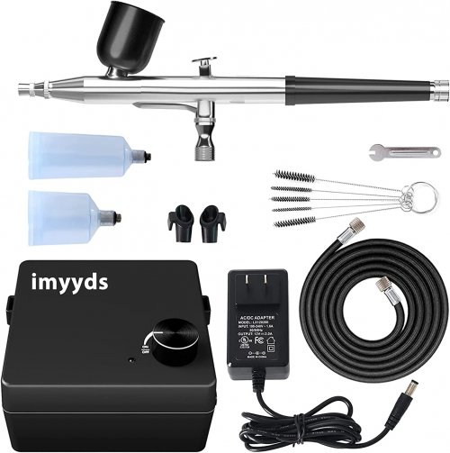

Thank you! I have a cheap, double action gun with a tiny compressor that is adjustable. No pressure gauge, but I figured it will work… max pressure says 35 psi. I have a professional, VERY expensive compressor, for metal engraving (past hobby) but I don’t have room or energy to use it now. So, the cheap one will do.
Acrylic, cheap hobby paint.
We live in (well, near) the middle of nowhere, so there are no hobby stores. Probably 250 miles to the closest one. But, youtube has millions of video how-to instructors to sift through.

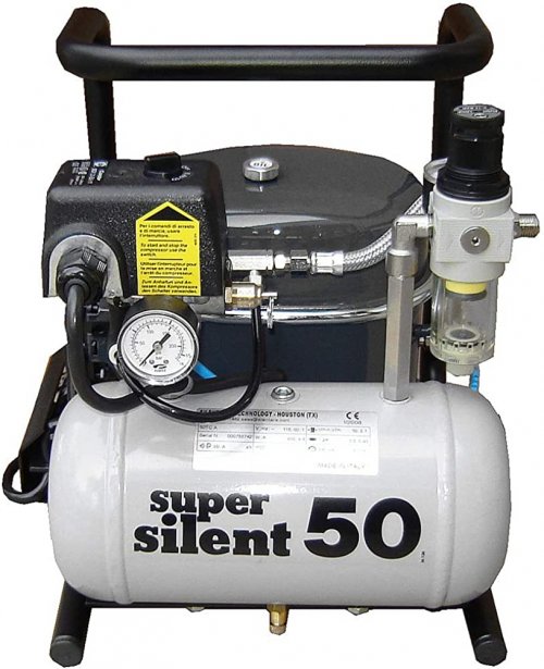

This is the air brush I got. They had a big discount at the time so it came in at right 50 bucks. It appears to be very well built. I thought if the little compressor dies eventually, I’ll just dig out my fancy one. It is a Silent 50 compressor.
Reactions: micahrogers
