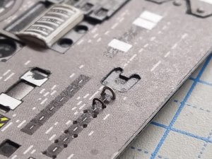

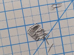

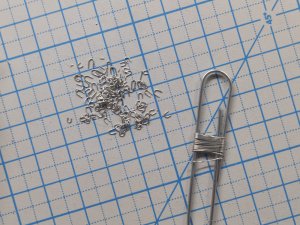

I bought 0.25 and 0.3 mm wire today. There is a new 0.3 mm wire divider on the front, an old 0.4 mm wire divider on the back, a difference of 0.1 mm is very visible and looks neater.
In half an hour, I cut 200 pieces at once, maybe more, in the end I lost count.
The rework forced me to come up with a new faster way of slicing deciders. After removing it from a paper clip, I cut it all in a bundle.

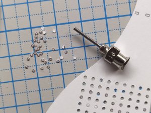

I also punched through the screw heads. For this I used a reusable needle, sharpened inside.
When using such small punches, it is imperative to pull the part out of the needle. Otherwise, the needle will quickly fill up with paper and stop punching, and it is very difficult to clean such a thin needle.

I'm looking to get some small punches like that. Anybody have any good recommendations?
To the existing flux needles purchased from the electronics components store, I ordered this set with a handle.
1 Set Metal Embroidery Stitching Punch Needle Handmade Needlepoint Kits Sewing Tool Set With Tube For DIY
But these needles need to be modified. First, they need to be cut and flattened, and then sharpened from the inside. And you also need to squeeze the place of attachment of the tube and the body, otherwise after several blows on such a punch, the tube will fall inside.

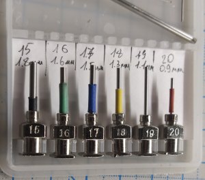

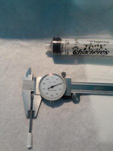

I don't know what "Gage" it is... but the needle that comes in the Tony Chachere's Creole injector has an OD of .1185
You can buy them at the grocery store. usually on the isle that has the BBQ sauce.
I use needles for a flux dispenser. This is the exact OD in mm for the needles I have from G15 to G20.
15-1.8, 16-1.6, 17-1.5, 18-1.3, 19-1.1, 20-0.9 mm

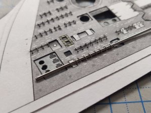

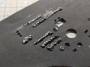

In the meantime, this is the fourth time I rebuild the panel from the beginning.
II was not satisfied with the fastening of the dividers, as the wire began to fall out and does not stay in place. I re-printed the sheet with the panel, started to make, but immediately glued the transparent part, and the installation of the wire in a new way became not convenient.
I printed again, prepared everything for dividers installation, but when I started to remove the tape from the panel, it came off along with the toner, apparently there was some kind of printing problem.
The third time I scratched the panel, dropping its floor and ran over it with the wheels of the chair.
This is a new, more reliable way of installing dividers. I decided to weave them into paper. I used a 1mm steel rail as a support for leveling the height. This was my second reason why I decided to do everything from the beginning. When I manually setting each piece of wire, I cannot control its height, and it did not looks good.
