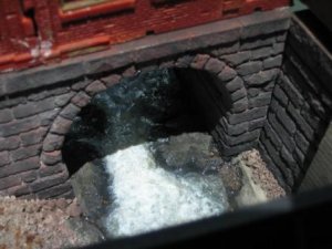

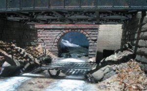

I finally got around to placing the bridge and the factory into the scene to get an idea of what the river will look like once the bridge is in place. I used a projector as a flood to give a nice crisp shadow of the bridge onto the river and enbankment below, but the scene will be under flourenscent light when installed in the layout...well, when the layout gets built around the diorama:rolleyes: .
I'm planning on putting a few kids playing hooky and fishing on the rock in the back. I noticed that there were large eyebolts sticking out of the stone work on the prototype that may have been used to anchor guy wires for a derrick during the construction of the factory and want to add some of those, too.
