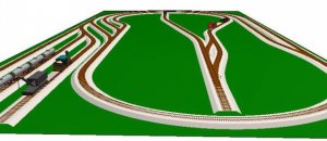

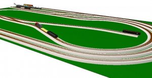

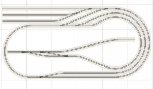

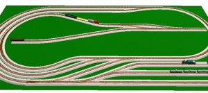

Hi Larry, I took a look at the photo you posted and thought I would give it a try in the dimentions you stated (36x72) and I could get it all to fit except for on of the sidings on the left hand yard. Of course the radi is smaller than 22".
What do you think of this.
Christopher the TrainClown ;)

Chris,Great job on showing that layout on a 36"x72" door.That is the route I would take if I was going to build this layout but,would add some of my druthers. :D
