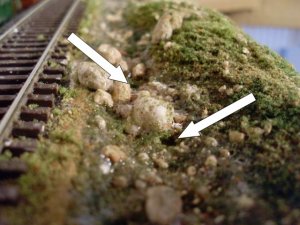

I did use WS Plaster Cloth and i did paint it with FolkArt Honeycomb Acrylic Paint. I only did one coat however and i have a feeling i should have done more then one coat wall1 wall1
Now i know for the future lol
Is there anything i could do RIGHT now tho that would still make this work without tearing up the affected areas and re-doing them? I want to avoid that if i can... :rolleyes:
heres a couple pics showing what the WS Realistic Water did where i put it down

Not an expert, but a guess.
I do see a lot of tiny little holes in the scenery. A couple really sticks out and looks like where the Real Water might of seaped out. Try plugging them up with some of those rocks you have. Then try re-pouring only a little bit in the spot you plugged.

Do you have a hot glue gun? if you use clear glue sticks youd never know it was there. Make sure you cover any future plastercloth with a second coat of something. I use plaster patch or joint compound because I have it laying around.
