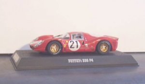

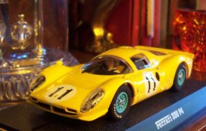

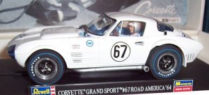

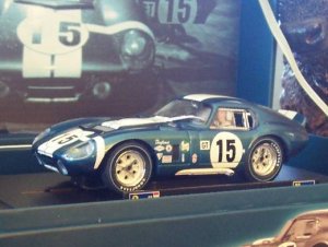

cnw1961
Jan 7, 2006
846
65
Germany
Very nice collection of cars. Gotta love those GT racing cars from that era, they are so beautiful. I did not have a P4, but a friend had one.

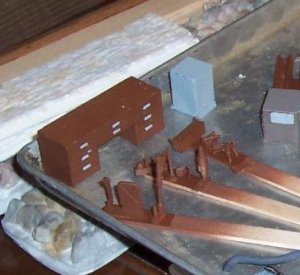

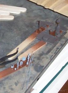

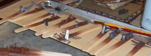

Heres a few of the detail parts I am putting together for this.
Call it: Round 1 of 3 parts
Garage Interior..round 1
Lean to Interior.. round 2
Exterior all...round 3
