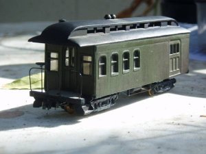

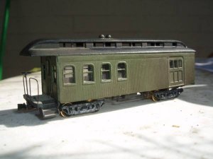

wpyr
Well I discovered I have a model power coach but...
Its a little long compared to my other wp&yr coach. How could I convert that Canadian pacific to a Wp&Yr car? I dont need to re paint it just change the name of the railway and make it shorter.
MilesWestern
Keep it the legnth it is, it's more prototypical for the YP&Y. The MDC car you have next to that is a Sierra RR coach, a small shortline in california.
wpyr
The samll "MDC" I got from the wp&yr gift shop. There are 6 differnt passenger cars and they are all that size. I can order them over the net. But I want differnt types of the cars they have. All the cars are the same size as the one on the left.
MilesWestern
"MDC" is Model Die Casting, or Roundhouse Products, the companry that made those cars, from a Sierra RR Prototype (They modeled it after the real thing) and they are NOT correct YP&Y cars. That's what I meant to say, but they sure look nice! :)
