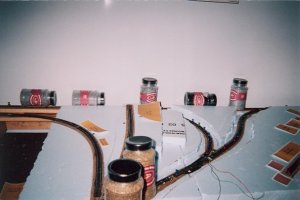

you are thinking small, guys... don't cut the foam into small bits, leave it as big as you can make it. Don't glue the foam down, first mark the track out on the top of the foam. Cut the foam just a little thicker than the track and cork roadbed. Then mark the sides of the foam with the incline you want. Take your large knife and cut the incline from the underside of the foam. What you have left is a long piece of foam with a smooth top and a varying thickness that represents your incline.
That is how I did it for the rear "WYE" on my layout.
