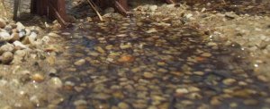

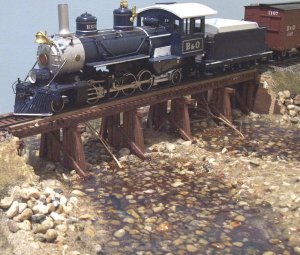

I finally got to the point of using the Woodland Scenics water. The first pour kinda soaked in to the streambed, so this is the second pour. There are two more photos in the On30 Forum, "the On30 conspiracy".

Hi Sumpter,
Thats a great looking bridge to say the very least. With only two pours its sure looking great already. I'm getting ready to pour a large lake and been practicing on some scrape pieces of wood. It sure soaks up on that first pour for sure. I had a heck of a time getting the bottom painted to look good but I think I got it right now. It looks to me with a few more pours you will have it just the way you want it. Also a good looking steam engine. Have fun.

Ron,
When you get that lake poured, post some pictures!! Apparently, not many of us have played with this product, so any comments, good or bad, will help those who are thinking about using this stuff.
Pete

Ben H
Yes I like it - nice job.
Gives a very real natural look to the wet and dry rocks.
Your trestle is real right on ties in nicely with the scenery you have developed around it

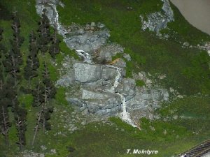

Here are some photos of the water fall I made on my layout using this product.

And here is another. I also used WS Water Effects.

Have you guys noticed any shrinkage and fogging using the Realistic Water? I used it on the stores layout and there was some shrinkage of the first pour
Dan,
Now that the second pour has set up, the shrinkage is defined by a "lowering of the water level" between the rocks.
Was the shrinkage reduced by thinning with water? I would suspect that the surface tension would be less with a thinner medium, but I would also suspect the shrinkage to be greater because of evaporation of the water.
I will have to do another pour, and see what happens.
Pete

sumpter250
multiscale modelbuilder
Dan,
Thanks for that information on shrinkage. I'll thin the next pour, and see how it turns out. Where I want to add some details (like fish), it might be better to have the "water" thinner.
T.
The engine, a Bachmann/Athearn kitbash, is a work in progress, as is the diorama.
Pete
shamus
Registered Member
Hi Pete, love the trestle & the water looks excellent as well. Where are the swans?:D
