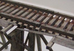

Regarding the Weather-It, it is capable of staining wood to a fairly deep grey if you ignore the instructions. I cut all the pieces for an abandoned trestle I wanted to build and put them all in a ziplock freezer bag with the Weather It. I left it overnight, maybe 12 hours. Here is a pic of a section of the bridge. The rust from where the rails were is painted on.
WOW!jawdrop
That looks amazing! Very well done!:thumb:
