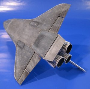

My SSME plumbing was thin strips of laminated silver paper. I laminated it, cut it into thin strips, then curled it around the edge of my knife to curl it.
The belly of the MARS Center orbiter isn't that bad, except the body flap has tiles going only one direction instead of two. I think I used an enlarged version of the AXM body flap, but it's been awhile so I don't really remember. Once I weathered the belly with gray and black pastels, everything looked ok.
