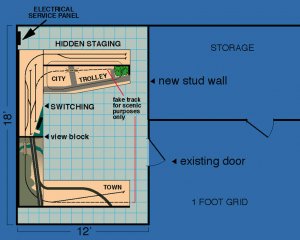

Robin, I've given up on the continuous run for the trains, and now everything has fallen into place in my head.
Aartwmich, hey girlfriend, fun is where it's at. I'm using Adobe Illustrator to plan this out. It works for me. 1 mm = 1 inch.
Okay, thanks for standing by. Here is my new and improved, still ambitious but not insurmountable layout:
cheers
:D Val

Originally posted by jon-monon
Like what you've done with the place, Val :) Curiose: why do you want to block the view, instead of have the city naturally end and turn into country?
Well, it's because I want the train coming out of a mountain tunnel and going over a steep gorge. We don't have any mountains here in Toronto, and I'm still kind of hung up on that prototype. Also, I want to pretend that it's very far away from the city, and it seemed the best way to achieve that effect.
