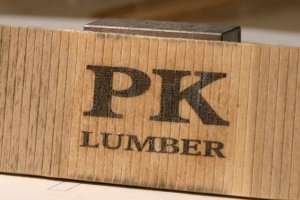

This is a test I did yesterday, I printed it on MicroScale laser paper after first giving the paper a coat of dull cote, then I let the ink completely dry, gave it 2 coats of Testors Decal Bonder (a small can I bought in Wall Mart long time ago and never used), when dry, transferred it to the wood and the used MicroSol (twice) to set it. After it had dried I gave a another coat of dull cote, and this is the final result.
See, the 'cracked' paint is the print, that's how it looked when it dried on the decal paper, and is not caused by the transfer. I think the result is useful, but not perfect.
The small letter size is 10pt.
I tested it on a piece of scrap, so that's why the wood has different color, it's not because of the decal, actually it's almost impossible to see the decal, except if the light hits in in just the right angle.
Jon, this PK Lumber has no relation to the well known 'PK Boiler Co' or other 'PK' named industries :)
