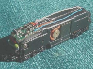

Even Z scale can be fitted with the latest in DCC. The photo shows a Digitrax DZ123 squeezed into a Z scale Micro-Trains F-7. Yes, the shell does fit over this.
- ZeegleN
