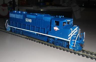

I've always had great results airbrushing with acrylic paint. Never had a problem so far with them and I've painted & decaled alot of my locos. I think its experiance and personal preference really, but I've been painting with air for about 10 years now. The Navy put me through Aircraft painting and final finishing courses.
Here is a link to my latest paint & decal job. I used Model Flex Jenks blue and Microscale decals.
http://i118.photobucket.com/albums/o111/65gasser/MP1.jpg
