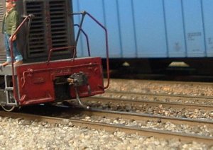

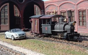

I use brown, alternating dabbles of black, dark and light grey craft paints from Wal-Mart. Our club uses some over stock basic brown latex from the hardware store. In both cases, after the paint drys, we push a hard wood stick along the tops of the rails to clean the paint off. BTW, the ballast used by the club is sifted sand from locomotive sanders picked up at the Flomaton, Ala. yard. One of the members has access to the yard as part of his job.
