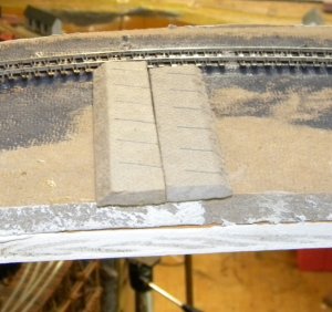

Cleaning up my railroad room I found some scraps for homabed, and I took a picture of them , so you could see what I am talking about. In the photo there are two short pieces of the pieces of homabed (slotted), up against some of my Hon3 track on the fifth level. that level is being built on pieces of homasote cut from a 1/2 inch thick 4x8 sheet. if you want to see how that works, check my thread over in the logging, mining, and industrial section.

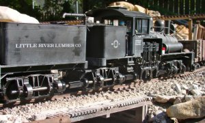

I use real rock and dirt. Unfortunately it does wash out from time to time and has to be replaced. Part of the joys of Large Scale Model Rail Roading.
