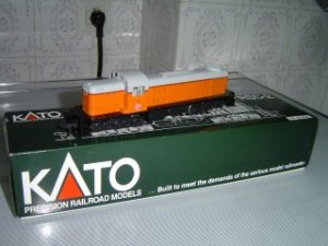

I finally got my Alco RSC-2 from kato. You'll probably call me mad, but, what I'm going to do with it is... scratchbuilding...
I'm going to depart from a Milwuakee Decorated loco, and turn it into a portuguese CP 1500 series locomotive in it's last orange livery. I'll post here developments as I'm making them...

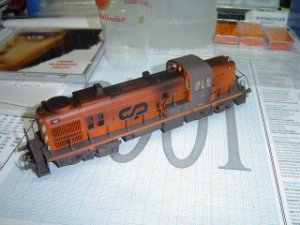

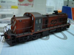

And now, ladies and gentlemen!
Now... two views of the complete and weathered model... a genuine 1500 series portuguese CP locomotive ;)
Hope you all love it like I do :D
