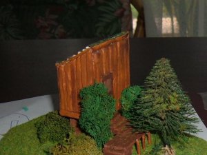

Ok i have just about finished it. Now before we look at it remember it is made as a FIRST scratchbuilt. COmpletely from raw materials. nothing (windows ect) was bought, just paint,foam,balsa ect.
Im not quite sure what it is and its a bit bigger than HO
ill put something in the pic for reference.
i will put lots of pics of a small model =)
lets have your opinions:)

Hey that's not to shabby for a first time out. Look's like it could be a multi person out house it you add another door on the other side and put "Men" "Women" on it. Trainclown, I made one of those line shed's last week from a sheet of styrene and some wood from a JV Models Haliburton engine house that was give to me this this past spring. Nt everything was there so it's being used for other build off's. The line shed came out pretty nice with a visable wood frame much like a real house. It even has a bench to sit on and seat's 2-3 crew members. Only mistake I made was that it wasn't tall enough. The guy's hit their head's on the roof brace's so they have to stay hunkered over a bit lol. I'll try and not make that mistake again next time. Until then they'll be complaining about headache's to the yard master over the radio because they keep bumping their head's!

Not bad at all, especially for your first attempt. One of the things that helps to set scratchbuilt structures apart from kits is that you can make them site specific, as you've done by placing yours on the small diorama.

Good stuff... I like the steps and walkway...
Try looking for blueprints, like on this site:
CERC Blueprints index
You can buy them full-sized (for real buildings), but they're easily good enough in 'preview' as A4 pages for model making. Some nice sheds and farm buildings, with dates so you can get things a bit appropriate.

hey thanks for your input and im checking out that site.
ill put up a pic of the roof and you can tell me what you think is good or bad about it

Not a bad first build. This is how you would improve it. The roof should over-lap at the edges. You should cut the boards straighter and not work them so much. They look whittled, and you want to try and stay away from that. Less hued, more saw cut like. If you are going for a hued look, then make the tool marks way smaller. Remember, a little tiny dude built this, so the tool marks should match his tools.
I don't think your finished painting it, or, the color should be muted with a lighter color, dry brushed over that color to lighten it up. It's too dark right now. Even if you paint it blue or yellow, you should still weather the surface to give it some age. Weathering is a good way to bring out details too. What you have done isn't wrong. Lots of guys paint the dark shadows first then dry brush a lighter color over the dark. This gives a nice shading effect. You should darken the end of the roof beams too. Right now they are to bright and catch the light.
Could be a fishing cabin. Or a dynamite shack from a mine. A trappers supply hut. A smoke house beside a river. A place for your mother-in-law when she comes to visit. :D
I hope this helps.
