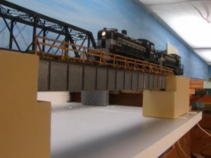

The Soundtrax drop in decoder for the 2-8-0 won't work on DC. The new Tsunami does, and is available for $80.00, you need to solder it in tho. The BLI Mike might be your best bet, make sure the one you buy has sound, I think they are available without sound now.
Nice to see another Atlas Shrugged fan. Here is a photo of JGL # 588

As a matter of fact, yes. I'm in the process of working on a scene which includes the first ever Rearden Metal bridge, only a mile or so from the Rearden plant (I've moved the JGL from Colorado to NJ) Not a chasm spanning bridge, just an extra long girder. Seems a 100' girder is no problem for Rearden metal. I tried a bunch of colors striving to obtain a "blue green" metal, settled on this as others just were too odd.
