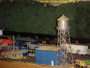

A few notes about the ground foam.....use uncolored foam and then add green and black paint. The foam I used in my 'how to' was a foam used in bedding. This is the same stuff that is in seat cushins on couches and chairs. (its free when people throw old furniture out ;) )
As for water, you should need more than a cup...and dont forget to drain it before you dry the foam, or it will take forever to dry.
These trees can look close to other trees once you get the hang of it...I use them mostly for the masssive amount needed for the area in the appalacias that I model. I use some woodland scenic trees in the foreground. But once you get good at making foam..it should look as good as what you buy.
For those that havent seen my website, I have added a picture from my 'Dante yard' area of my layout. All the trees you see use homemade foam.
If you have any other questions or need help, email me at kpsub@hotmail.com place "foam" in the subject , line as I will treat those emails as a 911 call..:)
Tony, CSX's KP Sub in HO Scale
