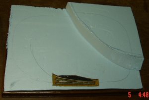

As for the layout, it's a small one to have at work, it's dimensions are 30*40 cm (12*16 inch) so it's not even small, it's micro. It's a small oval with a litlle branch. It'll have at least three structures (from the faller catalog), a tunnel and lot's of trees :)
Here it is a photo:
