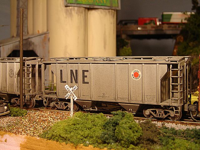

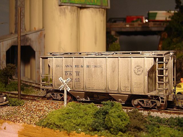

Ralph
Great looking overpass and weathering on the hopper!
