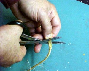

I found this big pile of twine out in my garage...it's what's commonly known as jute, or 'baling twine'...this stuff is great for making tall grass...

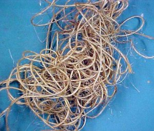

Start by cutting a piece about 3-5 scale feet in length...

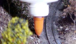

...looks about like this in N scale...

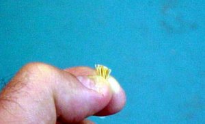

Now put a drop of white glue where you want the clump of grass to be...

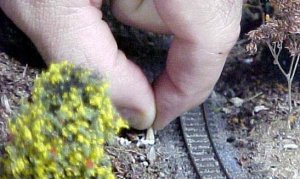

You can kind of poke the fibers, spreading them apart, & you'll get something like this...
