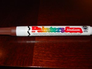

I was in your boat not too long ago. Here is a pic of what I used. I run HO and I use the medium size. I took the applicator out and then used my xacto on it. That way it didn't get all over the ties and ballast but it worked well because it did hit the tie spike heads, close to what the proto looks like in my parts. The hard part is the turnouts. I was lucky enough to run into a mis colored paint at the local lowes that almost exactly matches the pen. I use a brush to hit some of the turn outs where the pen doesn't hit. The pen I got at the local Micheals. I probably did about 75 to 80 feet with Three pens. Check my pic in the photo contest for the results. I think they are pretty good for a rookie.

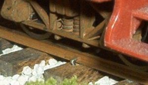

I do the same as David and Gary. A small brush works well, and although a little patience is required, the end result (I think) looks nice.:)
For this picture, I used Floquil's "Rust".
