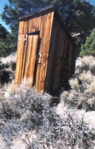

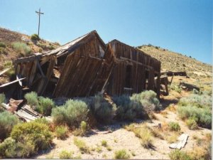

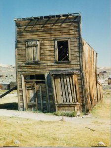

Just take a train ride anywhere and you are sure to find one or two of these. Mostly deserted farms because the children grew up with different interests. Lots of them in Saskatchewan eh! TrainClown

Saskatchewan has a plethora of ghost towns, but most of my experience comes from when I lived in B.C. and hung around such ghost towns as Barkerville and Stout's Gulch. I just love the stories you can gleen from exploring these old buildings. Golden memories of my youth. I guess thats why I want to make a model like that, to take me back to those happy days.
