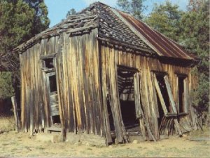

I thought I would post a pick of one of the buildings I want to model, just to give you all an idea of what I'm trying to do.
I love those rotten buildings.

Well Trainclown, I'd say that qualifies as a dilapidated structure! Kinda reminds me of the time I dumped that box of wooden toothpicks on the floor!
stripwood
I have to agree with you, TC. That picture is about as bad a bldg as I have seen that is still standing. Those type fascinate me for modeling because THAT is real life. I think a couple of those would make any layout true to life. A few small trees and lots of weeds, and bingo, it would fit any era.

... I think a couple of those would make any layout true to life...
But many more than a couple could get the layout condemned. :D
That was my home just before the builder finished construction. As usual, he had to come back to take care of a few things after we moved in.... :D :D :rolleyes: :D

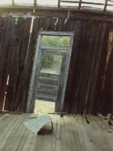

That moldy oldy is what is left of a school house. Here is what it looks like from the inside.
That dern door is stuck again!
