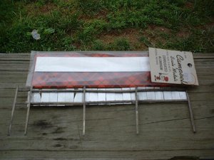

So I'm building a fence for my junkyard out of stained basswood and Campbell's metal #805. Now I need to weather it because it's shinier than even new tin. I read/heard somewher to use Ferric Chloride (circuit board etch). Anybody ever do that? Any other ideas. Ideally I would like to bush something on and it's done. I'm lazy that way. I would like it to look 10 to 30 years old, not clear rusted out, but not looking like the inside of a new beer can. I'm all ears. FRED

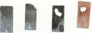

Ferric Chloride smokes!
So the first piece was immersed in the Ferric Chloride. This is a time delay reaction so nothing happens at first. I thought maybe the metal had a coating, but if it does alcohol don't take it off. But once it starts it reacts fast, but not uncontrollable. The color is black so it will not work as a coloring weathering agent. :( But it eats, so I tried just putting a corner in and that works well for rusted out against the ground. (Piece2) So then I got out a small paint brush and pooled a puddle and let it eat, then scraped off the black with a knife and did it again. Then I turned it over and did the same until I got a nice rusted hole. (Piece3) So I did another and painted it with acrylic craft paint. (Piece4) I like that. It's extreme weathering, but it's going to take more than 1 step to do the fence, but it's not going to be hard. I'll work on it tonite as it's at home. I'm happy with the results. BTW, the Ferric Chloride boils and spits when it gets going, so follow Vic's saftey list. :thumb: :thumb: :thumb: FRED
belg
Does this acid only attack metal? If so a set off chopsticks would work well to emerse the parts in the acid,Yeah or neah?
F
Fred_M
It don't seem to effect stainless. I used hemos and they are uneffected. I use hemos for everything anymore, pliers, tweezers, painting, pickin my , ummmm, I'm sharing too much again. :eek:ops: FRED
PS, I used toothpicks to help form holes tonite and they are still there, just discolored on the ends. FRED
