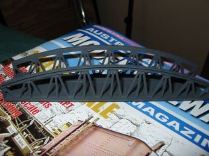

I need some advice on how to weather a bridge.
I purchased the Vollmer Arch Bridge and sprayed the whole thing Polly Scale Grimey Black. I would like to know what I should be doing next. I have a book called "How To Build Realistic Model Railway Scenery" By Frary, but it only goes into details on weathering rock formations and stuff like that. It has no details on weathering structures.
I bought the Polly Scale Weathering pack which Im hoping will contain all the necessary colours to do the job. I had to order them from 1000 miles away. Ive only found one place in the whole of Australia so far that stocks Polly Scale paints....
If anyone from Aus is reading this and they know of some places that stock it, please let me know.
Anyway, the colours I have on hand without doing another mail order are as follows...
Reefer White, Earth, Roof Brown, Rust, Rail Tie Brown, Aged White, Mud, Dirt, Aged Concrete, New Gravel Gray.
Thanks for any help you guys can offer,
Troy.

Thanks George, looks great!
I can get the Chalk from my local hobby store but the Dull Cote
may be a problem... I don't know of anywhere that stocks it in
Australia. Is there anything that could be used as a substitute?
Also, speaking of substitutes, Im looking for a substitute for Polly Scale Roof Brown (I only have one little bottle to cover 90ft of track and its extremely hard to get hold of Polly Scale paints in my area). I took a sample down to a hardware store and had them make up a sample pot of Acrylic house paint.
Needless to say, the house paint is not the same as Polly Scale. It was an exact colour match but it won't stick to plastic when I airbrush it on. I thought Acrylic paint was all the same but it seems as though its not...
Any suggestions? Anyone?
Cheers,
Troy.

Troy,
Sorry, I don't have an answer for you on the Dull Coat. You might ask the guy at your local hobby store. Dull Coat is a clear dull finish "paint". By the way, in the interest of accuracy, my bridge is HO. The weathering technique is the same, it just takes less materials to do in in N scale :)
George
