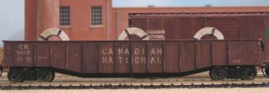

Ralph's post about Kings Port Steel got me inspired to finish this gondola since KPS is a supplier on my layout.
Here's a view of it heading under the crane for unloading.
  • gon_3/4.jpg
    gon_3/4.jpg

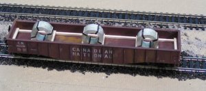

A top view showing whatever you call those lumber supports (?). I've seen photos of this before and the lumber used is usually brand new, so that's what we have. I made nails with a fine tip marker at the ends of the boards although they don't really show up.
I got a lot of the rust for this paint job by letting an SOS pad sit in a jar of water for a couple of weeks. It produces a very bright orangey rust which looks like "new" rust. I like the slight texture it imparts.
Val

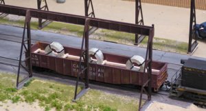

Here's a closer view of one of the sides. i scratched off some of the lettering before weathering. In the background you can see another dirty old boxcar and behind that the Walthers Machine Shop kit.
This was a fun little project that only took an hour or so. (Gotta do something while the chat is down!)
Val

Finally a close-up on the lettering. I also lightly sanded with a very fine sandpaper called Crocus Cloth. It removes the paint from the rivets (which I figure would be the first to go) without leaving any abrasion marks.

That's nicely done Val....chipping away at the lettering was a good touch. Thanks for the tip about Crocus Cloth. Seems to be the perfect tool for the job.

Thanks Ed and Ralph. I should add that I also used an Xacto knife to scrape at the lettering. Another approach would be to lightly paint with the same colour as the car itself. I'm going to try that at some point too.
Val
Beautiful work, Val. The wood is called bracing or shoring, and it is used to keep the load from shifting. It is always new wood, but usually the cheapest grade obtainable. When the car gets to the other end, and is unloaded, the wood shoring will be tossed. They use new wood because it is cheaper to have a stack of new lumber to cut to length than it is to pay good wages for someone to scrounge through scraps to find useful pieces of lumber.
Thanks for the info Russ. This gives me a modelling idea - a stack of discarded lumber beside the overhead crane.
