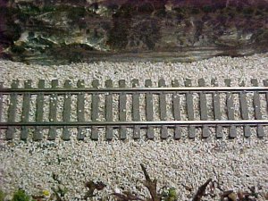

Here's the unballasted track on cork roadbed...

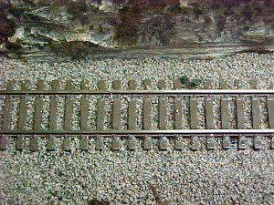

Now here's the Woodland Scenics ballast spread, & ready for bonding...

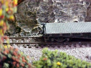

Now, instead of just using "wet water" to wet the ballast, I use rubbing alcohol, with a few drops of India Ink, to make a black wash...this not only wets the ballast, allowing the glue to flow through it, but it also darkens the ballast, & gives it that grimy look I was shooting for.

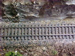

I don't know if these pictures really show it, but by weathering your ballast, it really blends it into the surrounding scenery more realisticaly

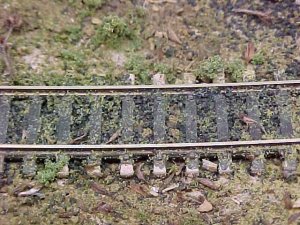

This is how I did the ballast (orlack there of) on my switching layout...I just scenicked right over the track with dirt, & other ground cover...Later I added some cinders to fill it in a little.
I wanted really trashy looking track. for an industrial branchline.
